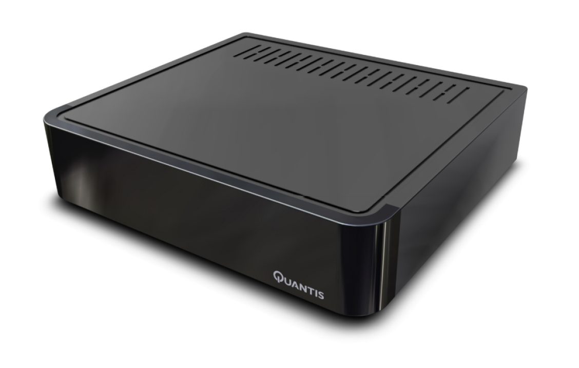

Digitale radio ontvanger (Quantis QE317)
